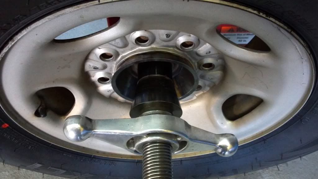

you dont even need that adapter, i've balance all four of my rims with out it. you just put the cone in from the front with out the plastic cup on the over sized wing nut and tighted it down. next time i balance a tire this way i'll take a picture and post it

see this is how i set up a balancer to balance wheels, no need for the cup and no scratching of the finish of rims. most good auto techs know how to do this

Umm, that's not the chrome-clad (plastic) wheels we are speaking about.
The proper way to balance those wheels is with pin-plates, the adapters shown above from Hunter, Coats, Hofmann, Corghi, Bosch, Etc. Your wheel was without a doubt damaged by the first shop when they mounted the wheels using the plastic cup adapter with their balancer.
Also, just as an FYI to 09Nitetrain you shouldn't be outside coning a wheel like that as it may cause the balancer to chase weights, the outside of the rim is never made to used with a cone as the cone may not sit properly. Never mind the fact that the wheel could be lug centric vs. hub centric. I have balanced wheels like that myself until I started selling tire equipment almost 10 years ago & went to numerous training courses. I know you do what you have to do in a shop to get the job done but over 80% of the so called balancing problems we have with equipment & wheels is caused by improper mounting FWIW. Whenever I am on a sales or service call now & start talking with techs about balance problems I can usually trace the root cause back to improper mounting or cones that are beat up & dinged.

i never had an issue doing it this way. even checked it with a road force balancer and it was always spot on, and when it comes to chasing weights then i know there is an issue with dirt being on the hub, cones or its not center and check all these and then correcting the issue, rebalance the tire and no more chasing weight
You are correctm, like I said, I have done it myself, I was just saying that the "proper way" is to never outside cone the wheel. I am a Bosch wheel service ASR & while I have done it the same way as you plenty of times in the past the textbook way & the way I have had the least tech calls/issues on is to cone from the rear or use pin plates.
