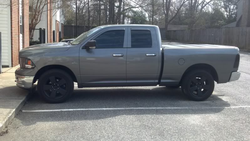

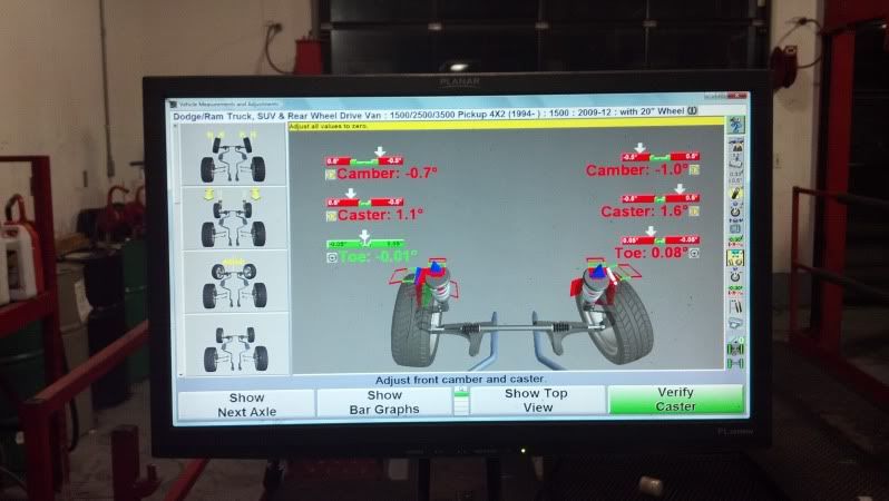

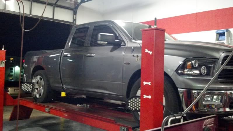

Put it on tonight, I got the springs from another member on the forum and for the price couldn't turn it down! I didn't get a chance but to get a fews pics while I had it on the alignment machine.
Before:
Suspension after alignment:
Adjusting the Suspension:
I will post pics sometime tomorrow, there is more pics and info on my build page: http://ramforumz.com/showthread.php?t=61681&page=27

What's up with the two color wheels?? Hahaha how do you like it? Are you 2WD or 4?
I had the chrome covers for my wheels they threw in with the deal when i bought it so i plasti-diped the covers and i had to take the covers off to latch on the alignment arms.
