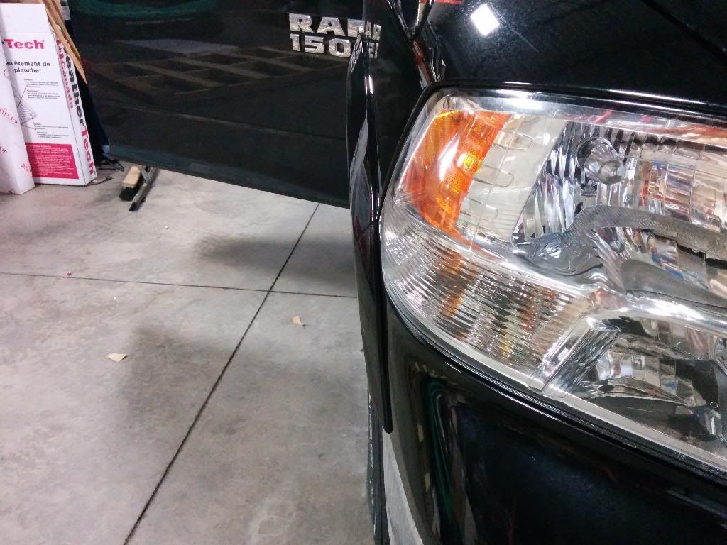

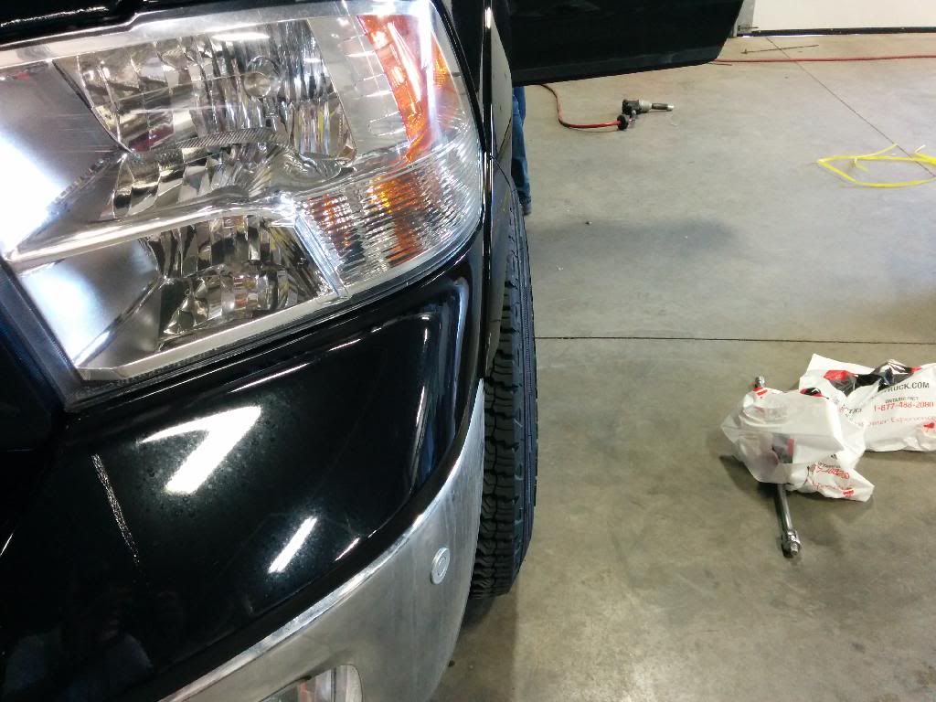

I went from +25 to -6. Here are two pics:
(Sorry it's on two different sides)
Before:
After:
Now I went from a 7" wide rim to a 9" wide rim, so at least in appearance, some of the bulge of the side went away going to the 9" rim. It could just look that way? :)
