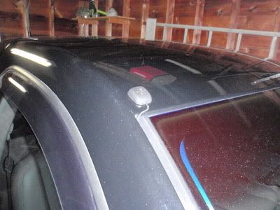

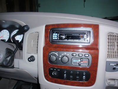

So I was not impressed with the stock sound of my RAM. Did a little research and found what i was looking for from our friends at Alpine. After reading tons and tons of different RAM owners talk about wiring up aftermarket radios and blowing the stock amp I choose the Alpine CDE-124SXM from Crutchfield for $199. Alpine sells a Power pack for their radios to boost the capabilities of your stock speakers. (Apline KTP-445 power pack) Though I didn't blow the amp.... this would have been my option instead of rewiring the speakers. Back to the head unit. The head unit comes with a sirusxm tuner, usb port, aux port, and the capability of playing pandora. The XM tuner is tucked in the dash zip tied to the cables in the dash and the small antenna is easily routed through the glove box and is hidden nicely. First impressions- Sound is unbelievably better. Sounds like i have a 10 tucked behind the seat. The only problem i have now is the 11 year old speakers can handle the max power of the stock amp. I'm not big on being loud i just want good sound so it's perfect for my preference, but we all know what happens when "that song" comes on and you crank it. A tip for you guys wanting to replace the stock radio is make sure you find the right wire for the amp. My diagram said the power antenna and for my model it's not.
