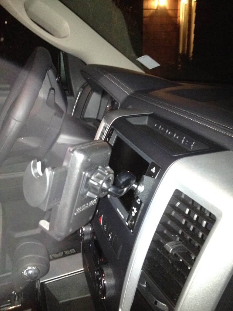

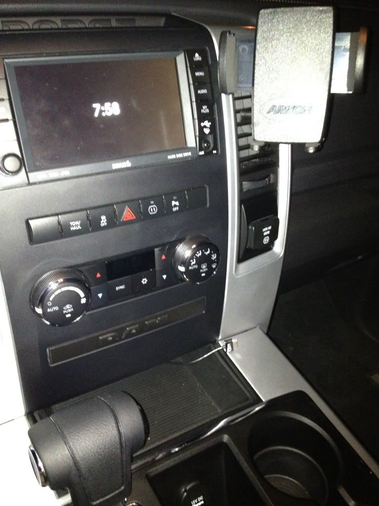

Installation took approximately 30 minutes from start to finish. Biggest challenge was taking off the center bezel around the radio. This is the most difficult part and slightly nerve racking I would hate to break a piece. Once that was done, removing a single screw and installing the bracket was a snap. Just follow the directions and you are all set.

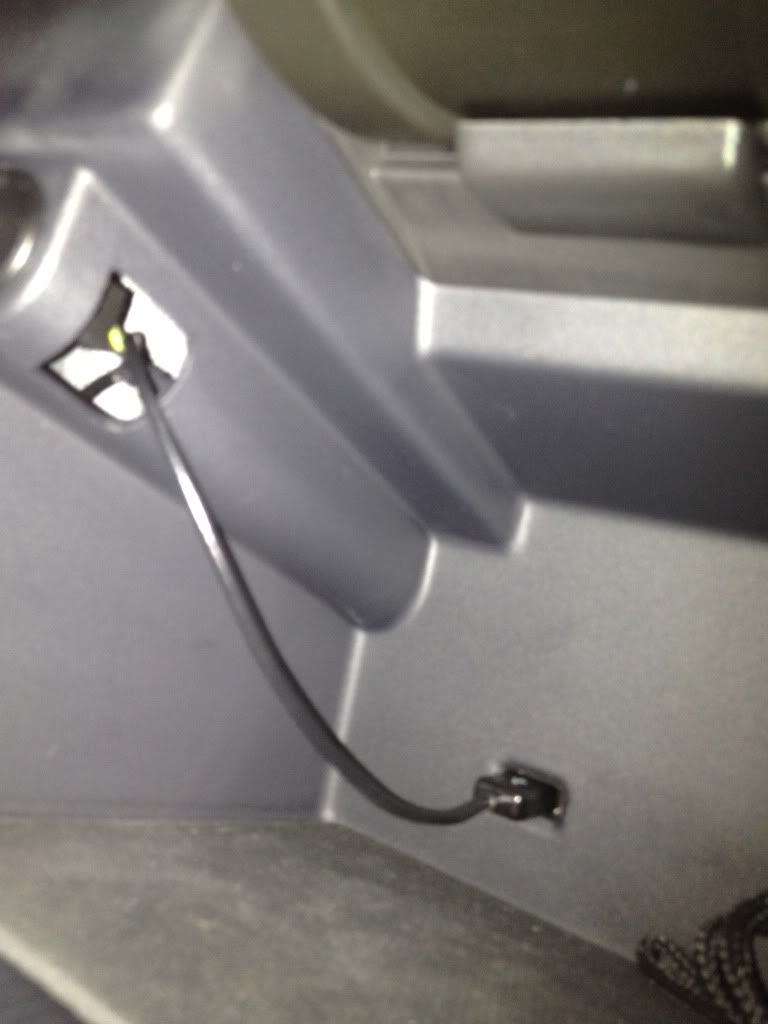

If you plan on running the iPod cable through the glove box you will need to remove the lower glove box completely. The cable can be run through the glove box light. You may need to do some trimming if you have a glove box light, but if you have a Sport model which never came with it like mine running the cable is easy. Just push it through the hole and it drops behind the lower glove box and you can then run into the whole of the center bezel. Really easy. I recommend pulling through as much cable as necessary. This way you always have some if a friend wants to plug his iPod in and use it in a comfortable fashion from the passenger seat.

This was an easy installation with okay instructions. The bracket only mounts to one screw and is not 100% sturdy. I would feel safer with two screws. The bracket comes with an extender and if you don't put the extender on before mounting the bracket I guarantee putting it on after is going to be a pain and you will probably damage your radio because putting on the extension requires lots of force. Once it is on, the movement is smooth. So only the initial application is difficult.
It does shake a little when you click on the phone, but if you put your hand around it, it feels very comfortable easier to use and no issue with shaking. The holder itself is great and easy to use. It will work on almost all phones and I can leave my case on, the main reason I purchased it.
Adjusting the phone holder is easy and once in place it does not move. The best part about the bracket is there is no suction cup, so it will never pop of. All the screws are already on your truck so no drilling, if you don't like it you can take it off easily without any damage to the car. My favorite part is that it appears as if the truck came with the bracket.
