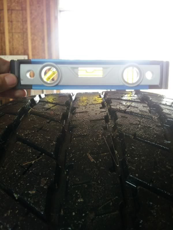

Well guys, I will let you be the judge. I have been having issues with them pulling since I pulled them out of storage, I got it aligned checked everything. Now today during the process of elimination, THIS!
This one tire I ran on my Passenger Side Rear all last summer (I mark them before I put them away for storage) and the others are all level.
Do you see something wrong here?? Junk
Going to goodyear thursday here to try and get a new one under warranty:att:
All the others:

I've spent every day after work for the past 3/4 days trying to figure out wtf was going on. So finally I narrowed it down (tons of tire swapping), pulled the level out and wala.
The wear is the same on the tire, you can say its kind of bubbled? I guess. I got 4 more nightshifts than off to deal with this.
Just a pain in the *ss when the tires themselves have less than 12000 on them and this crap happens.

wow man that sucks, at first I would say alignment issues but if you had that done then obviously that isnt it, actually judging by the first pic it would be hard for a bad alignment to forum grooves like that... good luck with warranty, keep us posted on what you find

That tire ran on the passenger side rear all last summer. It never saw the front end.
I thought it was just a bad alignment at first too, but had it done. She was dead on
So by process of elimination, this was the cause. Tires have maybe 12K on them.
