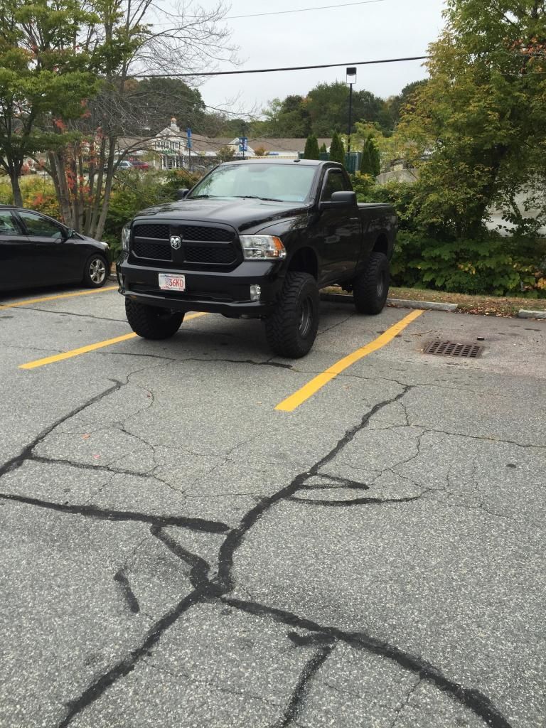

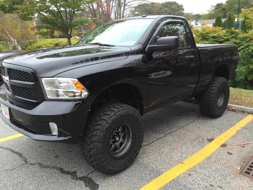

I just installed a 6" with 5" rear and it seems to be doing just fine for me? I'm not sure why he would say that. Here's mine, Bilsteins are set at 1.4 though.

Well here's a side view with 1.4 for the front. I dont think that there is much rake at all?
Besides i know a lot of people having them set at 2.1 also without issues. I'm sure they will chime in soon here.
