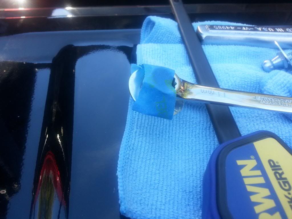

While the glue is drying you will need to construct a tool using a 10mm box wrench, zip ties and a length of flat anything. I used an adjustable wrench. Just make sure the total length does not exceed 3/4 the width of the tailgate. You will be maneuvering this tool in the open tailgate.
After making sure the glue is dry. Place the washer/nut in the end of the wrench. Make sure the angled part is away from the nut. This will help in placing the nut later. Use some tape to tape this to the end of the wrench. Do not use to much because you will need to break this off later.
If you do tape over the hole simply puncture it so the ball mount can be inserted later. Now take the ball mount and place the other washer over it. Put thread lock on the threads.
Now the tricky part. Remove the access hatch on the tailgate. Feed the wrench with the washer/net on the end in to the inside of the gate. Take your time. Do not hit the washer/nut on the side as it might fall off. Line the tool up with the far left slot against the tailgate. Now carefully insert it in the slot. This is a tight spot and not very welcoming for guys like me with big hands. Line up the nut with the hole that the nutsert came out of. Thread the ball mount in and tighten by hand. Then use a socket to tighten against the wrench in the tailgate.
Where did I go wrong you ask? Well I went to Home Depot to get new nuts and a new cheap box wrench. I figured if I was going to lose a wrench in my tailgate it was going to be a cheap one. I don't know if I just grabbed the wrong size or what but I grabbed an 11mm not a 10mm so when I pulled it out of the tailgate after taking the last pic to grab the ball mount I hit the side of my truck and the nut fell on the ground and rolled in to the drain. I sat there thinking "No, way did that just happen." I had another hardware kit from Dee Zee as a backup and just put a new nutsert in. If this one comes off I will do this for sure. I figured I would share now though.
