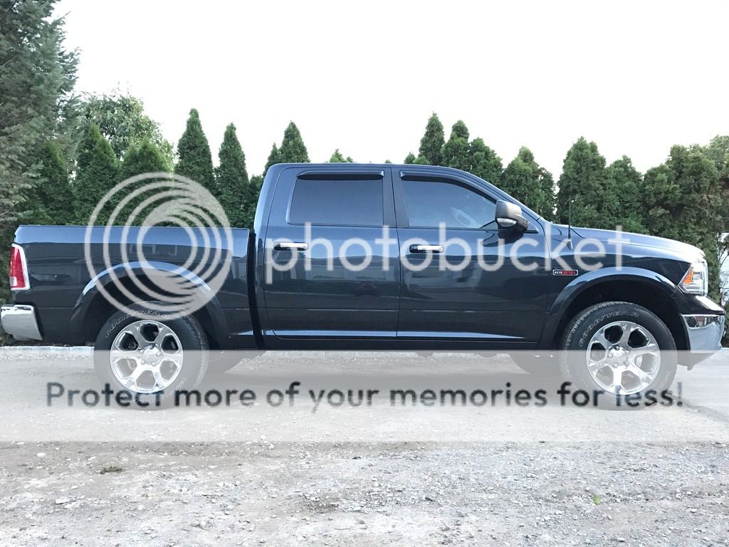

#6 ·
Just did a 2" lift and I'm switching my 20"s for 305/65/17 Ko2s... i don't plan on lifting the back and i do pull a 7000lbs trailer on weekends so I'm trying to keep the tires inside the fenders as much as possible but still fill it out. Plus I do drive the sh*t out of it so i really do need room for the tires/suspension to compress. Ill post some pics when i get the wheels/tires on there.. Going with Method Standards 17x8.5 0mm
